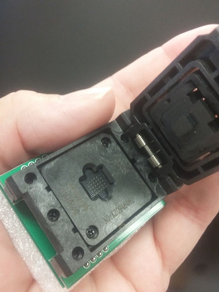

No worries, I'm waiting on a BGA24 fixture, in any case. Then some test parts.
The BGA24 seems to becoming more popular, conversations with Macronix suggest its a die stacking thing, but the SOIC16W (SOP16W 300-mils) is large and hugely popular across vendors, and without the assorted weird pads underneath like some of the 8-pin variants.

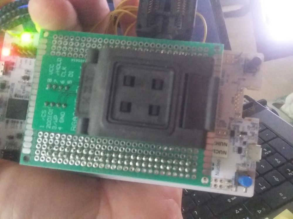

The MT35XL512's came in and I have them working on a test fixture, doing erase, write and read. Newark looked to have some MT35XL01G for under $15, so ordered a handful of those.
BGA24, 6x8mm, with the 5x5 ball window/frame

I have the MT35XL512 working on H743ZI and H7A3ZI-Q Nucleo's
code needs to be aware of pins, but also power supply, ie LDO vs SMPS on the boards, so that can complicate the support.
https://github.com/cturvey/stm32extldr/tree/main/h7_mt35xl512

Unfortunately the only ZIF BGA24 route to 8-pin, I didn't find any 16-pin options other that getting the sockets and fabing a board. The "Universal Programmer" approach does at least get the programming/verifying done, and the issues that dug up.
The MT35XL512 doesn't look to support the DIE ERASE commands, will see if the MT35XL01G's do when they arrive. Using the 0x60 for the MASS ERASE.
