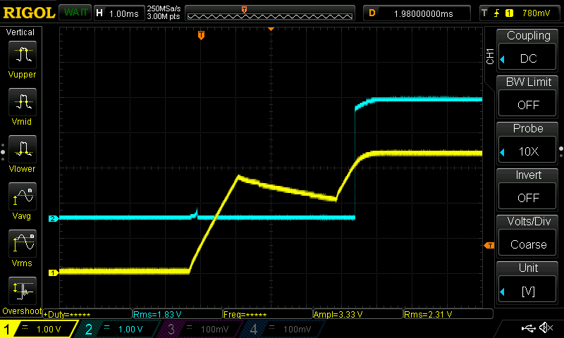

How comes you've shown us a monotone rise in VDD previously, and now there's that dip down to some 2V? What are the differences in the circuit then and now? The dip starts while the mcu is still in reset, so it's hard to accuse it of causing it.

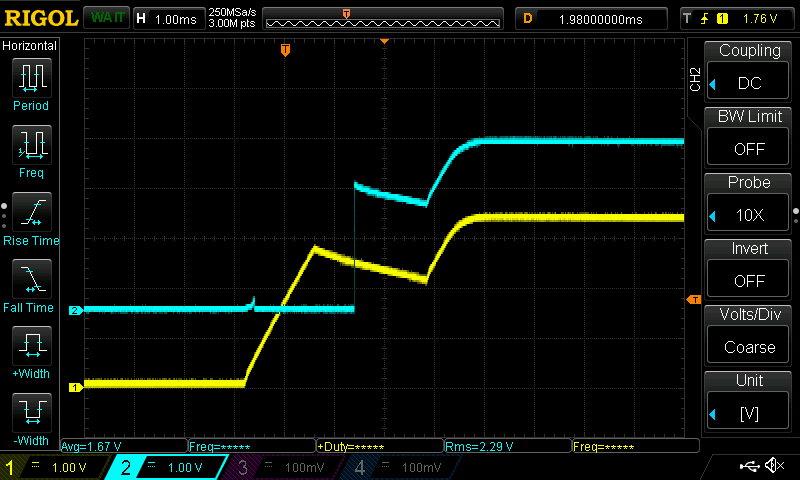

The dip in power supply is what throws off the simplistic resets, but IMO the POR/BOR in STM32 should be OK in that respect. I had expectations towards BOR being set, too. Please take that measurement with BOR enabled - you should see the reset extend beyond the dip.

I'm not actually sure what changed to cause the dip. I changed bench power supply, so possibly that...
Here is the same plot with level 3 brownout.

That's a hummm then... it looks exactly as it supposed to look.
