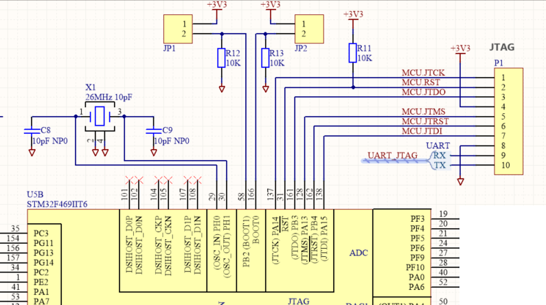

I measured the resistance between the BOOT0 pin and GND and found it was around 40K. There was dodgey connection between the jumper pin and the pull down resistor. Hardwiring the jumper pin to the pulldown resistor fixed the problem.

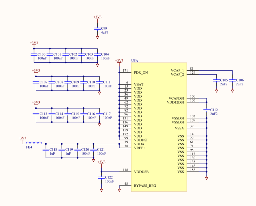

If you want me to look at the schematic, or portion of it, you can post that.
Things to be looking at are the analogue supply side (used by the reset circuitry), how the supplies ramps as power is applied, the value of capacitors on VCAP pins, and voltage measured there. Look at what is going on with the low-power domain pins, PC13, 14 and 15
Make sure BOOT0 and BOOT1 have defined states a boot up. Pull BOOT0 low.

VCAP_1 and 2 are 2.2uF. 1.32V on both.
PC13, 14 and 15 are being used a chip selects and measure 9mV on startup. What are their importance?
BOOT0 and 1 are pulled low.

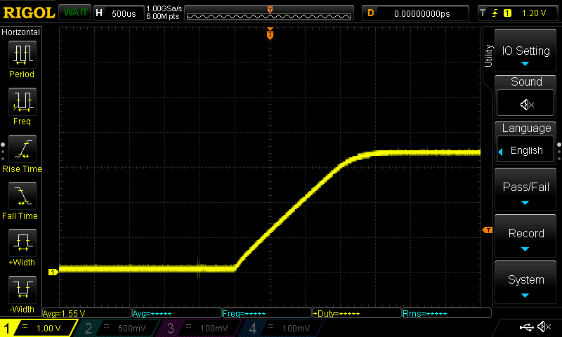

The 3.3V supply is ramping on in about 2ms. Is that possibly too fast?

- DS states VDD ramp min.20us/V so 2ms/3.3V should be OK
- pull down BOOT0 harder (don't be shy to ground directly)
- try shorting FB4
- I've never seen 2uF2 style of separating decimals (only 2u2 or 2.2uF, or 2M2/2.2M although this is perhaps not used since 80s) - made me think initially what the 2 suffix might meant... :)
