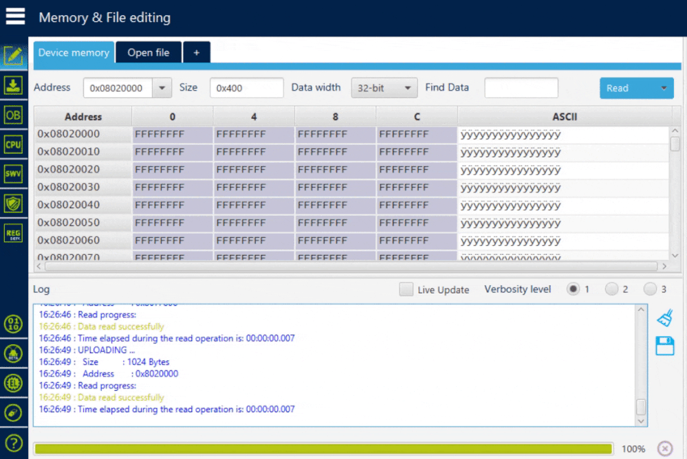

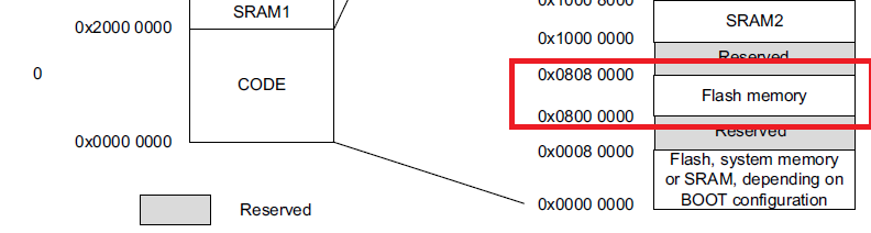

I am still in the learning stage and currently use the part of writing to the memory (Flash Memory). I have encountered a problem and would like to ask for advice:
From the picture (instruction manual) of [[Figure 1]], we can see that the blocks that can be written in the memory are 0x08000000~0x08080000
For the following questions, please refer to [https://youtu.be/iMChxrvMNG0]
Because I opened the memory to see that some user variables used the previous memory. I was afraid of being overwritten and changed it to 0x8020000 to start writing. However, after writing, I found that the memory will be cleared as long as it is restarted. Have you tried it? I tried to set the Initial break point, but found that it will be cleared as soon as the computer is turned on.
If it is written to 0x0807F800 (the last segment), the memory will not be cleared. However, I looked through the manual and did not see which memory block will be used by the system. I would like to ask why this is?

How does that write data to the memory?
You'd need to select the write tab, and write a .BIN file to a specific address

Hello
HAL_FLASH_Program(
FLASH_TYPEPROGRAM_DOUBLEWORD, 0x08020000 + (sizeof(test_flash_data) * (flash_cnt1/2)),
test_flash_data);
...etc via Stm32CubeIDE,It's all work fine,and i can see the written memory on 0x08020000
But after soft reset or power reset,the memory that i had written will be returned to 0xFFFFFFFF
So i changed my mind to test write memory via CubeProgrammer,After testing,I figured that if i write memory on
0x08020000,the memory block will be reset after disconnect and reconnect.
But if i write memory block at 0x0807F800(the end of memory that can be written),the data that i wrote will
not be format...
I'm used to be wondered if that problem is about the mode of power on(0x08000000->0x00000000),
but it's not seems to be this reason.

Need to be unlocked to program, so move the lock until afterward
HAL_FLASH_Program(..);
HAL_FLASH_Lock();
Your animation shows you edit the PC side memory, it does not illustrate you writing than content on to the STM32 Flash, which is why it disappears after you reconnect.
