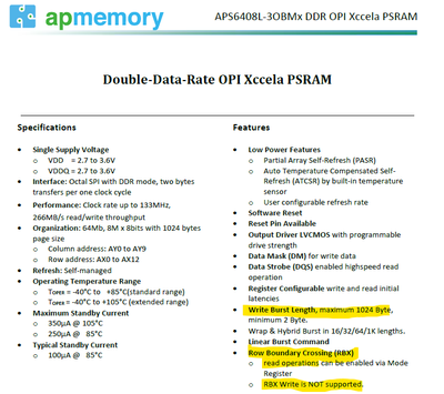

Hi Rikesh,
Maximum Write is 1 page (1024Byte for 64Mb, 2048Byte for 256Mb), and not limited for Read (RBX), subject that maximum burst length as long as tCEM is met.
I hope this help to reply to your question

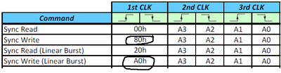

2024-04-16 2:04 PM
@Alex - APMemory , Thanks for your prompt response. I was assuming that the maximum write burst length of 1024 is only applicable for linear burst write(A0h). Is this true for sync Write(command 80h) as well.
I was using memory mapped mode and trying to write data using etl::copy functions,

Hi Rikesh,
Linear Burst Commands are required to support RBX Read
To write 1024B you need to write 1 full page, not crossing the Boundary (no RBX write)
This is apply to memory, whichever memory mapped mapped mode or other
Alex
