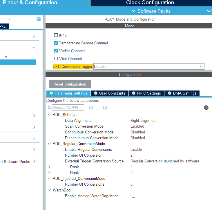

I was measuring the STM32F373 core temperature.
It seems that the core is 56°C while the environment is 23°C, no housing.
Is the 56°C a reasonable temperature? It looks quite high to me.
I used the settings below:
1 REPLY 1
waclawek.jan
Super User
Internal temperature is always higher than the ambient, and depends on the particularities of your application (clock frequency, number of active modules, load on GPIOs, etc.). However, +33deg.C is a tad bit more than expected.
Have you performed calibration before starting AD conversions, as outlined in the Calibration subchapter of ADC chapter RM?
Some other tips for this case here.
