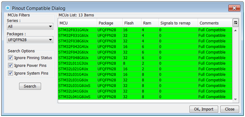

I m searching for a STM32L011G4 (16kb) compatible PIN to PIN mcu with memory>16kb. Is it exits ?

Regarding your request: you can use STM32CubeMX:
==> you will get the list of compatible MCUs with details about the package, flash size and Ram size.
