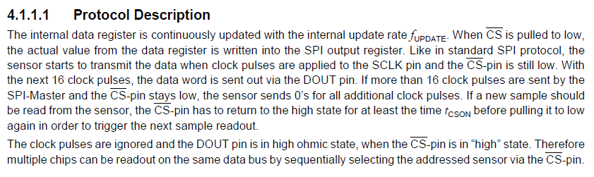

I'm using this current sensor: TLI4970-D050T4 According to the datasheet:
How can the SPI master send exactly 16 clock pulses to the slave? I'm using L432KC Nucleo running at 2 MHz, but the SPI clock has been prescaled to 1 MHz. I would appreciate any advice. This is the code that I use to read the sensor and calculate current:
