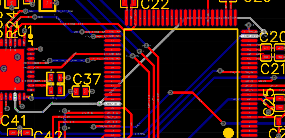

The f107-PA8 MCO is connected to f107-PA1 (ETH_RMII_REF_CLK) and to DP83848-X1. It's a 4-layer pcb with a proper signal and ground plane between red and blue, with only the vias through it:

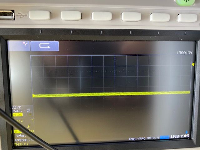

On my scope I failed to see any signal on the clock output when it runs at 50 MHz. I tried google and this forum, and found something that seemed to indicate that a resistor should be used in series from f107-MCO to dp83848-X1. So I cut off the trace using a knife (under C37). Still no signal. Then I also cut off the trace from f107-PA8 to f107-PA1 (at C20). But even with traces cut (multimeter tested) I see no signal on MCO:

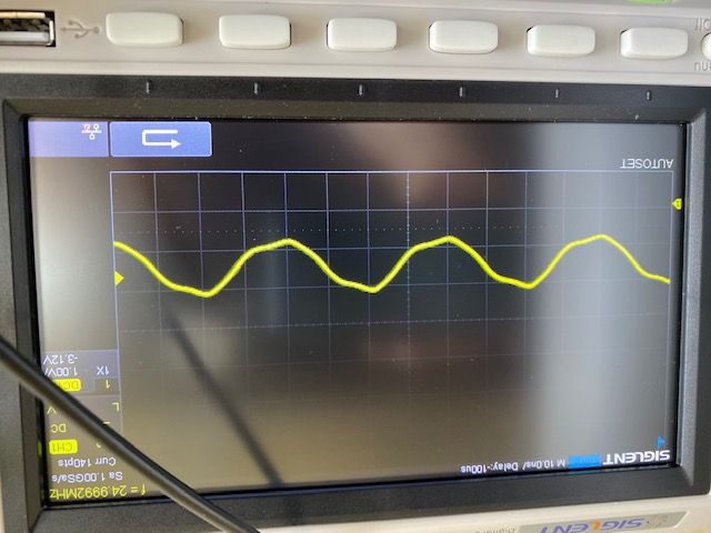

I then suspected that something could be wrong with the setup in Cube, so I lowered the frequency to 25 MHz, and then I see the signal. But to me it looks weak and distorted?

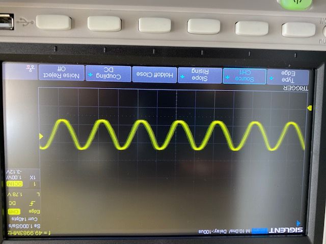

HAL_GPIO_Init(GPIOA, &GPIO_InitStruct);From my Cube setup I fail to see why this would happen, but changing GPIO_SPEED_FREQ_LOW to GPIO_SPEED_FREQ_HIGH gives me the following waveform, which looks much more like I expect it would:
