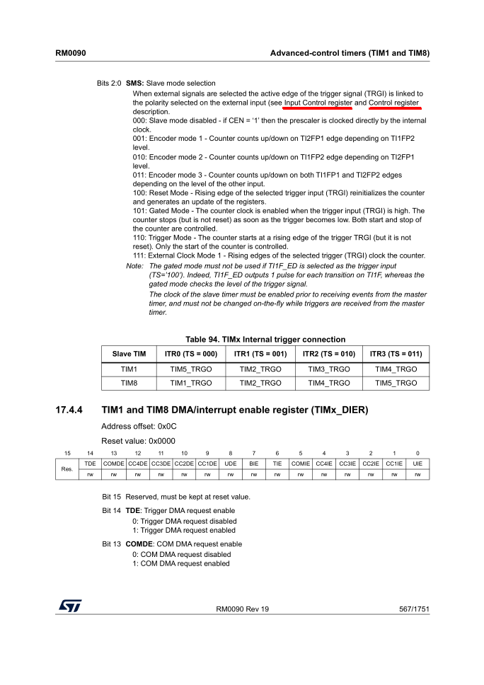

These are obviously leftovers from text which was in description of whatever mcu famiy the original source of this timer was (ST9 family?).
This of course goes across all timer chapters within this RM, and across several RMs.

Seems that it is present in all STM32 reference manuals starting from F1 up to U5 series.

Hi @Community member ,
Thank you for bringing this issue to our attention.
I confirm that the TIMx_SMCR description refers to nonexistent registers.
I reported this issue internally.
Internal ticket number 135679: (This is an internal tracking number and is not accessible or usable by customers).
