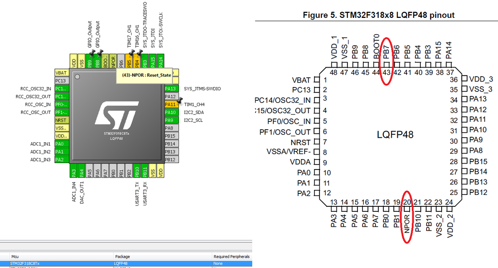

Hello I find ''
minor discrepancy'' between datasheet and CumeMX, alee last releas.
In DS is NPOR pin on position 20 LQFP48 and in CubeMX in position 43. and in DS is on 43 P7B and in CubeMX PB2 on 20 .

Hello
Kral.Karel
Your issue is no more visible on the latest CubeMX release (CubeMX4.24).
Please, update your CubeMX release with the latest.
Thanks and regards.
Jeanne

Hello
Kral.Karel
,I've reported this problem internally. Thanks for notification.
Best regards,
Tilen
