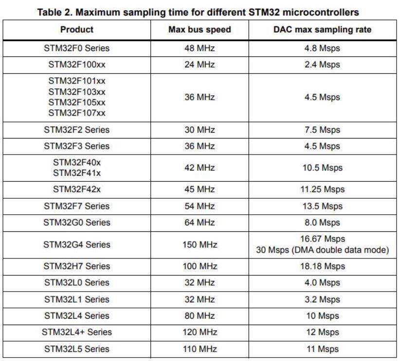

2021-09-15 8:07 AM
Hi @JKim.8 ,
Have a look at this AN4566 Application note Extending the DAC performance of STM32 microcontrollers. It can be hepful.
You can refer to the Table 2, shows the maximum sampling rate for different STM32 products (10 MSPS for STM32L4).
Hope this helps you!
Imen
2021-09-15 7:36 PM
The DAC sampling rate is not the key parameter. Start from the signal YOU want to generate. Specify its maximun slew rate. Compare it with DAC's, pass or fail.
