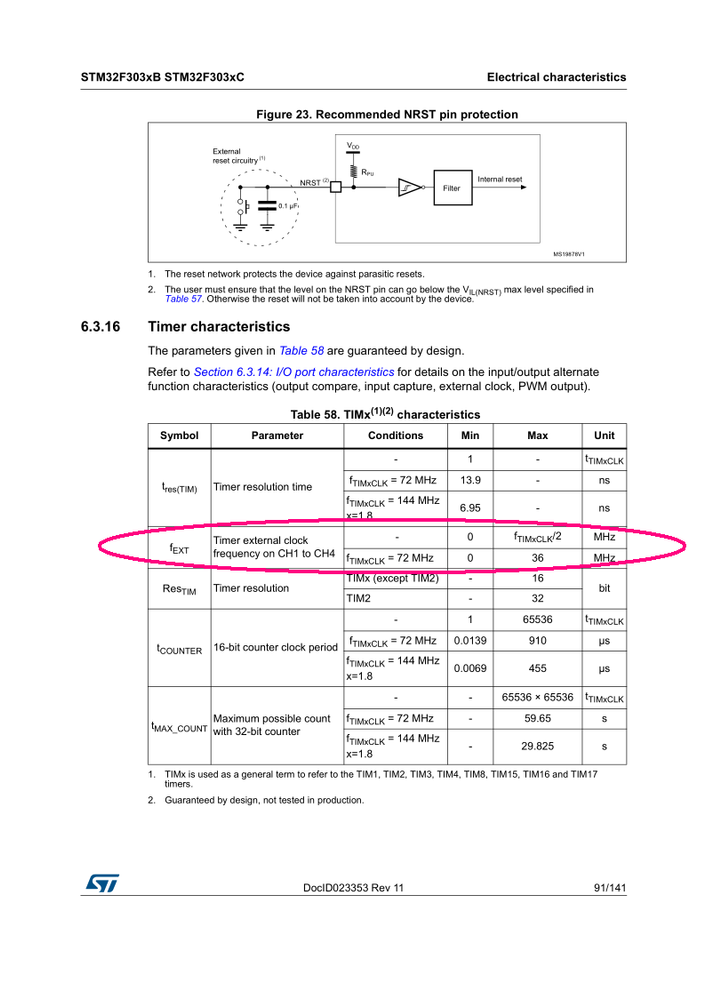

> So I don't really care about the time base of the timer, I just want it to increment a counter (up to 40Mhz)
The input frequency can't be more than half of the internal timer clock, i.e. 36MHz if you clock it at 72MHz; see my post below.
