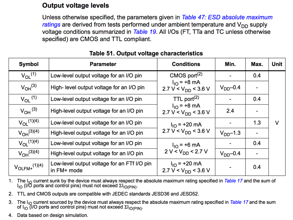

What is the maximum output current value of PWM using TIM? Where can I find it in the data sheet? I am using STM32F334. I am investigating whether the MOSFET can be directly driven by the PWM from the microcomputer without the gate driver.
On page 78/121 of the data sheet of STM32F334x4 STM32F334x6 STM32F334x8, the following description was given
Is IIO=8mA, 20mA the PWM maximum output current value? Which is 8 mA or 20 mA?

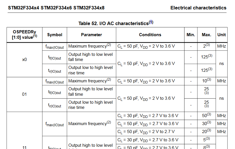

Hi Ken
Driving MOSFETs its not a static condition to make calculations with currents only. MOSFET's Gate has very high Ohmic resistance. Load Capacitance of Gate, and Frequency are the main factors to decide to drive a MOSFET (also min GateSource threshold voltage must be <VCC)
In dynamic conditions like you described , the appropriate table of DataSheet to look at, is

2017-09-16 9:40 AM
It's a CONDITION, that impacts the high/low voltage outputs. ie you draw more current the further VOL gets from zero
Look at the current tables, with max per pin, and max total across all pins.

2017-09-17 8:03 PM
Dear
Mr./Ms.
Clive OneThank you for your reply.
You mean that as more current flows, Vol increases.

2017-09-17 8:07 PM
Dear
Mr./Ms.
Vangelis Fortounas
The MOSFET I use can be driven at 2.5 V, Ciss = 15 pF. And I want to operate the MOSFET at around 100 kHz. Therefore it seems possible to drive without gate driver.
