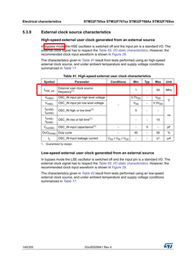

Should be an fEXT parameter, 50 MHz being quite comman in this case as used by Ethernet.
You should select HSE_BYPASS mode so it doesn't drive the OSC_OUT pin.

So, stm32f7 will run using 50MHz HSE despite the fact that max input should be 26MHz? But the thing is in bypass mode it will only run at 50MHz and it will not go via PLL. Where is this information documented?

The mode where it uses a crystal and uses an inverter is different to where is takes an external LVCMOS clock signal. The 26 MHz limit is that of the internal oscillator circuit.
The clock source then feeds the PLL. The clock is divided down to a suitable comparison frequency, so you can still hit the 200+ MHz numbers for the MCU off the HSE source.
