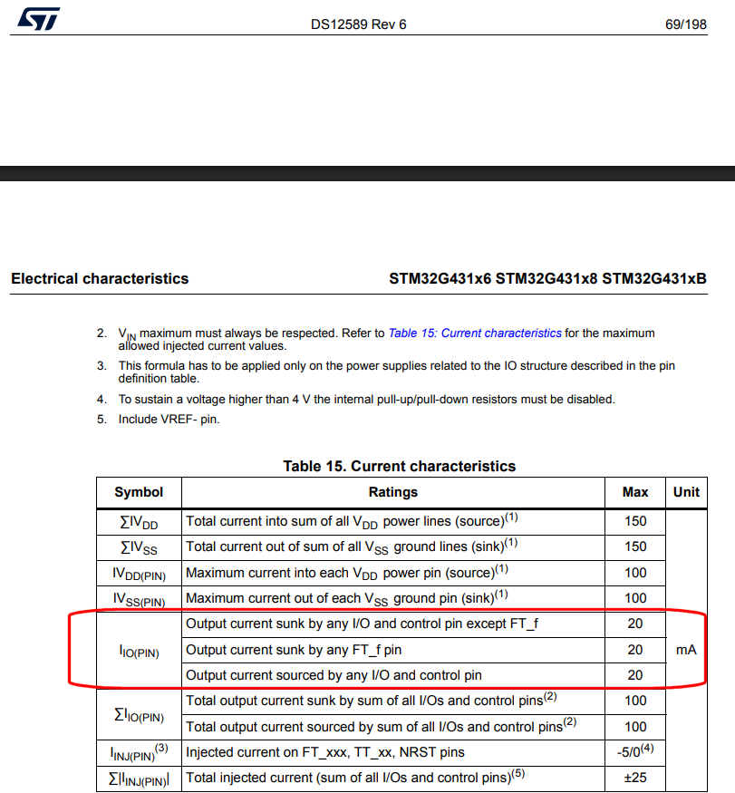

I am using an STM32G4 Nucleo-32 board (MB1430) and want to drive Relays with its GPIO; I need to know the maximum current that can give a GPIO. I searched on the datasheet of the STM32G431x6 , the maximum power that can be delivered, but found no values. Could someone tell me where to find that info?

Due to the inductance of relays, it is generally not a good idea to drive them directly from a GPIO. Instead, you should connect a driver stage in between, e.g. via BJT or MOSFET.
Irrespective of this, you can find the current carrying capacity in the data sheet of the respective STM32G431KB.

@Jad wrote:I searched on the datasheet of the STM32G431x6 , the maximum power that can be delivered, but found no values.
Really?
It's there:
Note also the maximum total VDD and VSS pin ratings.
But, as @Peter BENSCH said, driving a relay from a port pin is really not a Good Idea anyhow.
