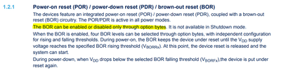

Hello @Anagha_Sasindran ,
The BOR can be enabled or disabled only through option bytes. It is not available in Shutdown mode.
When the BOR is enabled, four BOR levels can be selected through option bytes, with independent configuration
for rising and falling thresholds. For more information about brown-out reset I advise you to take a look at AN5096 application note precisely section 1.2.1 Power-on reset (POR) / power-down reset (PDR) / brown-out reset (BOR)

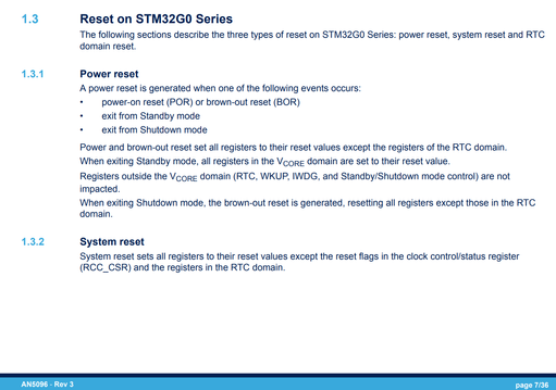

Hello @Anagha_Sasindran,
Power and brown-out reset set all registers to their reset values except the registers of the RTC domain.
- When exiting Standby mode, all registers in the VCORE domain are set to their reset value.
Registers outside the VCORE domain (RTC, WKUP, IWDG, and Standby/Shutdown mode control) are not
impacted.
- When exiting Shutdown mode, the brown-out reset is generated, resetting all registers except those in the RTC
domain.
Thank you.
Kaouthar
