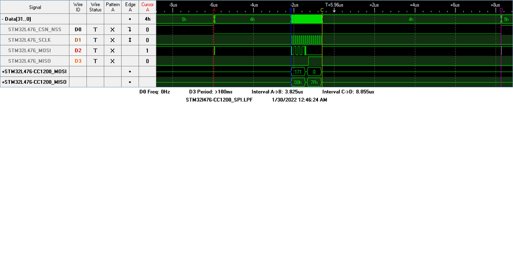

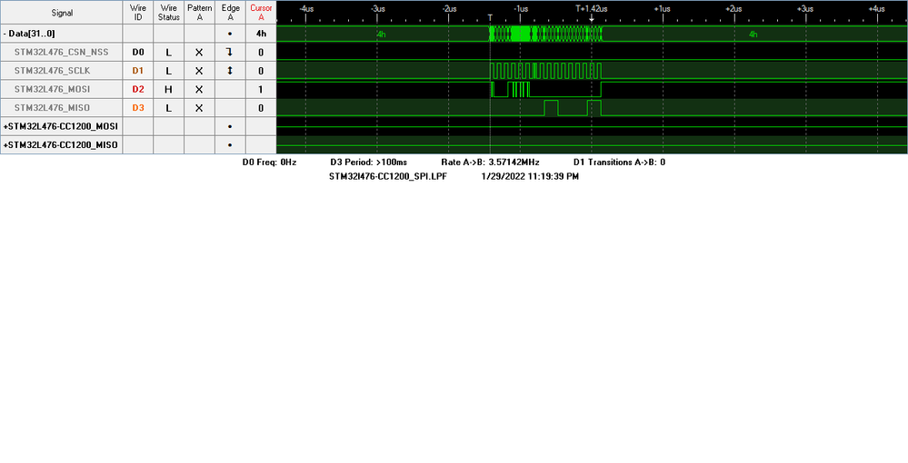

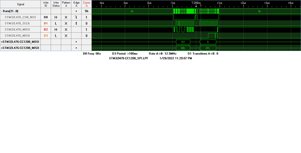

Interface of STM32L476RG to TI CC1200 SPI. Using MCU registers with NSS produces short acceptable CSN to clock start interval but I cannot get rid of the high pulse between frames which causes the CC1200 to malfunction. Manually configuring and toggling The CSN GPIO produces an unacceptably long delay between start of CSN low and start of SPI clock pulses but transactions work. My project requires optimized SPI transaction speed as there are many seperate 2 byte transactions that need to take place in as short a duration as possible. Inserting the CSN toggle into the HAL_SPI_TransmitReceive_IT or HAL_SPI_TransmitReceive functions shortens the duration between CSN-clock and visa versa but still adds significantly longer interval than the HAL NSS hardware output. 2 byte transactions are significantly longer than necessary.

Manual Toggle

Interesting that when NSSP is enabled CS goes low within a few hundred nanoseconds of clock pulse start. Yet, the peripheral is enabled long before that. Oh, maybe what you and RM are leading me to is that the high I am seeing before the first frame is the NSSP going low between frames??
