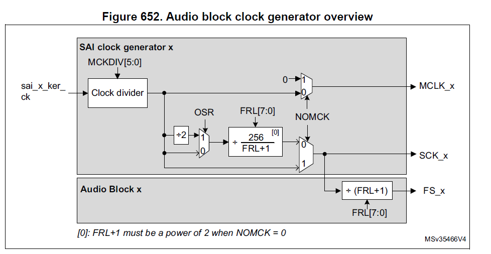

Based on the figure 652 within the TRM, it shows that the MCLK_x is produced by having NOMCK = 0 and just having the sai_x_ker_ck divided by MCKDIV,
in which case should have been 98.304MHz/4 = 24.576MHz, but somehow getting 5MHz???

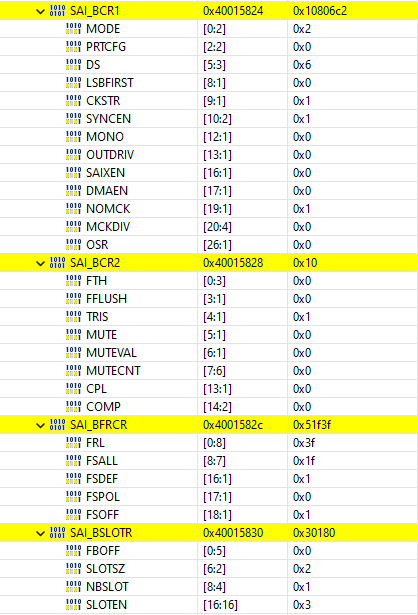

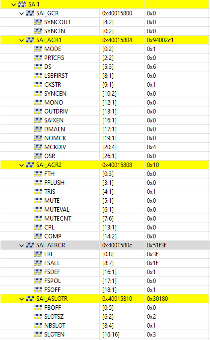

Picture of register of both SAI1 Block A and B
SAI 1 Block A reg:
SAI 1 Block B Reg:
Picture of SAI 1 Block A MCLK

At first glance the register settings look correct.
Have you checked the other clocks? Do you get the 6.144 MHz for SCLK ?
Have you checked the GPIO for MCLK, concerning the correct alternate function ?
As a workaround - mostly because I need other OSR ratios than 256/512 - I use another I2S peripheral as MCLK source.

2023-04-13 12:02 AM
@CLeo.1 Have you solved that problem? If yes, how?
If not: what are the exact register settings at 96 kHz, the peripheral clock, what do the output clocks do ?

The problem has not been solve.
The register settings is listed in the original question. The periperhal clock is using PLL2_P_CLK.
The output clocks are just shown in accurate, as shown in the original question, MCLK is completly wrong and the FS clock is shown also as 25MHz
