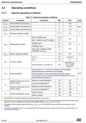

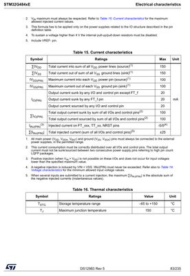

Indeed we have few customers going beyond our products specification from time to time and may work properly . They rely on their own application qualification at the required environment. You can see that our STM32G4 can sustain up to 150 degree in AMR ( Absolute Maximum Rating) it is a good choice for your application.
Cheers,
STOne-32
