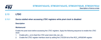

Hello @Franksterb92
I think you encountered the limitation when accessing LTDC registers as described in the STM32H753 Errata sheet
2024-08-28 6:56 AM
Hello @Franksterb92
2024-09-07 10:37 PM - edited 2024-09-07 10:37 PM
so would that just be setting the DIVR3EN Bit in the PLLCFGR to 1 to feed the pll3 to the ltdc if so i tried that and it does the same thing
2024-09-07 10:44 PM
lol i see it now its in the rcc cr register i added
RCC->CR |= (1U<<28) to enable pll3
while(!(RCC->CR & (1U<<29){} to wait for pll3 ready
wow i feel dumb now it works for now thank you so much
