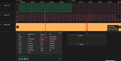

I'm working on a project using STM32U031, and using RTC with LSI(32kHz) to calculate elapsed time, and everything working fine, the waveform of LSI output also looks great.
And I need to switching power supply in sometimes, and there could happen the frequency of LSI become weird and average frequency change to ~52kHz, so i using LSCO and MCO2 to output the LSI and HSI, the HSI working fine when LSI abnormal, just like picture blow:
