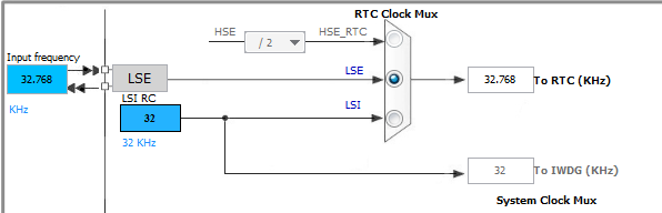

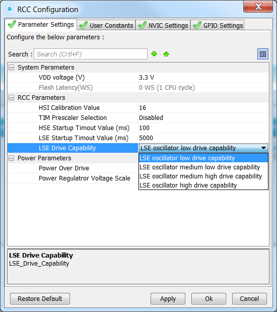

Hello STM32CubeMX is now fixed.
You can check it out by :
1. Enabling LSE in crystal mode
2. Enabling RTC peripheral
3. On the clock tree select LSE as RTC clock :
4. Open from the configuration tab, the RCC configuration window and check LSE drive option:
5. generate code and find proper sequence of initialization:
