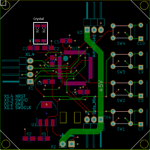

#stm32 #stm32f030 #rtc_waitforsynchro #lserdy #lse-rtc #lse #crystal #rtc #stm32f02017-02-23 4:04 AM
Post you PCB layout at aronud the crystal (or a photo).

2017-02-23 5:41 AM
Here is the PCB layout as asked. If you need more just ask.
Blanc Quentin

2017-02-23 6:53 AM
I don't like the 2 vias on OSC32_IN track and OSC32_OUT track seems too long to me.
You should start laying out your oscillator first to make sure the tracks are as short as possible.
But this is not bad enough to justify why your oscillator is not starting.
The EPSON MC-306 + 6pF capacitors is in the recommended listof
/external-link.jspa?url=http%3A%2F%2Fwww.st.com%2Fcontent%2Fccc%2Fresource%2Ftechnical%2Fdocument%2Fapplication_note%2Fc6%2Feb%2F5e%2F11%2Fe3%2F69%2F43%2Feb%2FCD002216pdf%2Ffiles%2FCD002216pdf%2Fjcr%3Acontent%2Ftranslations%2Fen.CD002216pdf
so it should be compatible.
Are you sure you did solder the crystal is the right direction?
