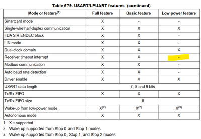

Hi @nicolas
I confirm Receiver Timeout feature is not supported on LPUART instance on U5, as stated in 67.3, making the RTOR register not relevant for LPUART.
Even if register might be present in peripheral, it cannot be used.
