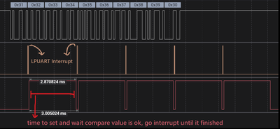

The task is startup and print information and delay 1 second, then entering an endless loop that includes a 1-second running delay and a 4-second sleep delay, and everything works fine in 1 second running delay.
But when sending bytes in sleep, it would occur overrun error when received length > 2, so i toggle an output while interrupt occur. and i saw an weird interrupt while receiving bytes, the record here.
To I modify tickless idle part, I disable sysTick and start LPTIM then go stop1 mode in PreSleepProcessing(), and restore everything and call vTaskStepTick() in the end of PostSleepProcessing(), and commit out the vTaskStepTick() in vPortSuppressTicksAndSleep() of port.c

2024-10-04 12:06 AM
i think i found the problem, the time to set CCR1 and wait CMP1OK of LPTIM is too long (2~3ms), it makes in the waiting time not trigger the interrupt until whole function finish, just like this:
my next step is to found out if there is any peripherals which can replace LPTIM.
and here is the timer code

// NOTE: wait here until the APB bus write operation to the LPTIM1 CCR1 register has been successfully completed, it takes around 2~3ms and the interrupt would not triggered immediatly.
