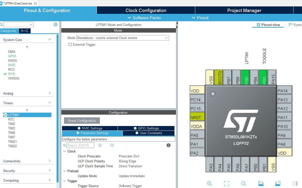

I am working on a project with an L081KZ and want to count pulses with a frequency higher than the clock. In the post here (community.st.com/s/question/0D53W00001EyzG5SAJ/) I thankfully got the tip to use the LPTIM as it has an asynchronous feature.
Sadly I cant get the LPTIM to run at all with an external clock and would like your help. There must be a fundamental problem I am overlooking.
I apply a signal (quite slow with 1kHz and 3Vpp) onto PB5 / LPTIM but neither do I get a 1/20th of the signal (counting to 10 and 2 times because of the toggle-function) on PB3 / TOGGLE nor do I reach the breakpoints in “LPTIM1_IRQHandler�?. In “Instance�? → “CNT�? is always 0.
Looking at the “Low-power timer block diagram“ i get i want the „LPTIM_IN1„ as input and not the trigger so I don’t get constrains by the Mux. Do I need to specify anywhere that it is PB5 or is it implied as there is no other pin possible? Also I activated the interrupt checkbox NVIC.
I configured the LPTIM via the CubeIDE as shown in the image and tried the minimal code shown below.
I would really appreciate a hint on what I am missing or where my assumptions are wrong.
Best wishes
Tobias

2021-12-08 11:03 PM
Dear all,
i would like to post a solution i found, so that others have it a bit easier.
Hardware:
Software:
I use the configuration as shown in the image with the checkbox for NVIC. The generated code is via HAL but the solution utilizes some LL functions, so we need to include "stm32l0xx_ll_lptim.h" from \STM32Cube\Repository\STM32Cube_FW_LXXXXXXXX\Drivers\STM32L0xx_HAL_Driver\Inc . After initializing the LPTIM we can set the missing bits with two of these LL functions whereafter the timer works as expected, counting up the pulses of a source with a frequency higher or lower than the system clock. Below you can find the minimal code I used successfully.
Best wishes
Tobias

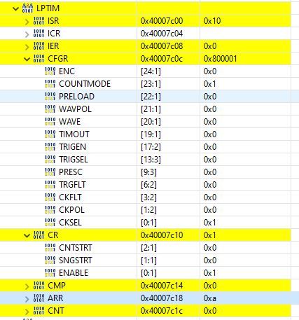

2021-12-08 2:34 AM
Read out and check/post LPTIM and relevant GPIO registers content.
2021-12-08 3:02 AM
Dear @Community member ,
thank you again very much for your answer.
I hope the attached register is what you want? If not please be so kind and refer me to the specific part (I'm quite new to the STMverse and HAL especially). I didn't post the GPIO register because the pin cant be toggled if the LPTIM doesn't count up and the Callback isnt polled (breakpoint is not reached).
Best wishes
Tobias
