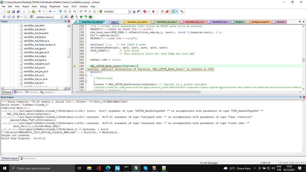

2021-12-03 7:31 AM
Hi, i had tried that but got compiler error!
