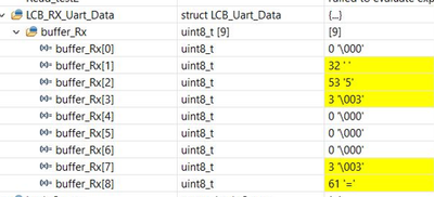

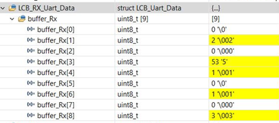

I am using UART6 of STM32H7 series MCU for reception of 9 Byte data . UART is losing first byte when receiving data on UART using interrupt.
Setup:
1. I am using full duplex RS485 (Modbus)
2. I have 2 MAX485 IC one for reception & another one for Transmission.
3. Data I am sending : Take for second Reception Image: 02 00 35 01 00 01 00 03 3C
when I do hit RxCpltCallback function in debugger I have observed that I am losing first byte of frame.
I have added two Snaps of Data reception. we can see the first byte is getting filled with 0 after that we are receiving data and at the end we are losing 9th byte.
do you think there is some issue with UART configuration ?
What could be the possible solution for this ?

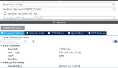

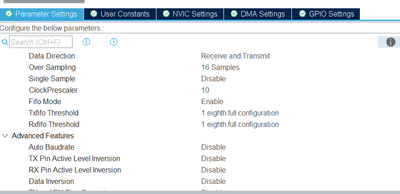

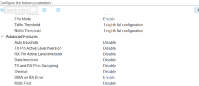

STM32Cube Mx Setting :

If you send 02 00 35 01 00 01 00 03 3C and you receive 00 02 00 35 01 00 01 00 03, the problem is not that the first byte is lost, but rather an additional byte is received before the first byte (0x02). Most likely explanation is the STM32 is receiving data on the line correctly.
A 0x00 character could be due to the pin toggling when it's being initialized. Do you have a logic analyzer to verify what's coming on in the RX line? If this data is being received in a circular fashion, the first byte could be from a previous transaction that was not fully read out.
