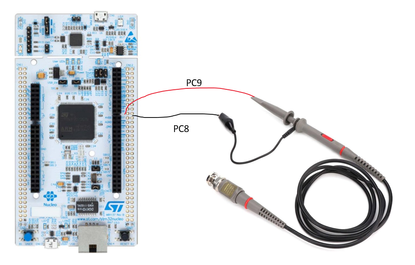

Hello TDK, thank you for your answer. Connection is like this;
And my desired outoput graph is this;
Nothing means straight line. Probably there is no phase shift between outputs. And the results no voltage differenceses between outout so nothing shows.
