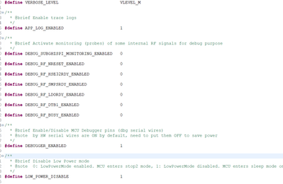

I checked the settings responsible for logging and debugging, and I see that they have the right values:

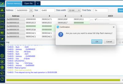

I usually only upload .hex code to the board using Cube Programmer.
Do you mean this erase as in the picture above?
2023-12-22 5:01 AM
Yes.

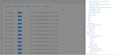

End device sends up messages to the concentrator as below:
But there are no debug messages on the serial monitor.
