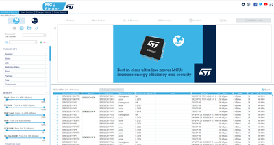

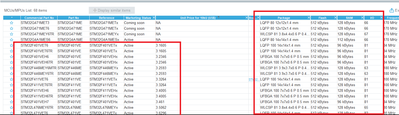

Please use the ST MCU Finder tool and apply your specific filters it gives also the raw price (of 10kU)):
I did the exercice and found the following list:
STM32F401VET is a good candidate for what you are looking for including the price.

2025-04-15 2:30 AM - edited 2025-04-15 2:45 AM

As well as the ST MCU Finder tool for PC (already mentioned by @mƎALLEm), there's also a version for mobile devices:
https://www.st.com/en/development-tools/stm32-finder.html
See also: https://www.st.com/content/st_com/en/stm32-mcu-product-selector.html
And: https://www.st.com/content/st_com/en/stm32-mcu-developer-zone.html
As @RobK1 suggested, Distributors often have good parametric search facilities ...
