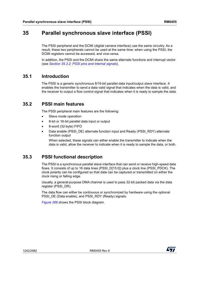

I personally would start experimenting with PSSI to provide buffer between DMA and the output.
2021-07-08 9:58 AM
PSSI?
2021-07-08 10:22 AM
PSSI!
