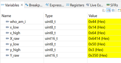

After debugging, values are obtaining as follows:

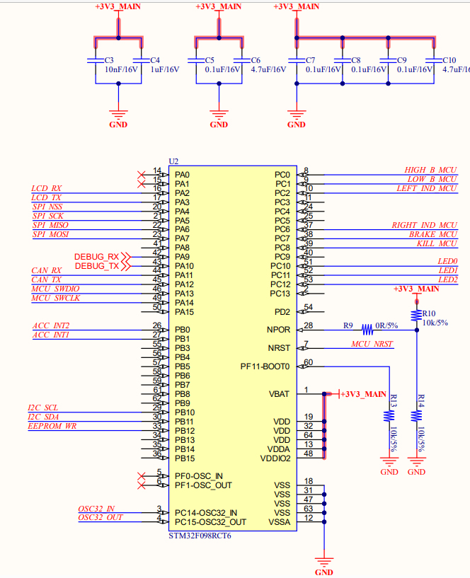

Please also post one for the STM32 part.
Why do you have a pull-down on CS ?
How is your PA4 pin configured ?
There is no other devices in the same SPI bus.
Here is the schematics of STM23 part:Screenshot 2024-07-30 144136.png

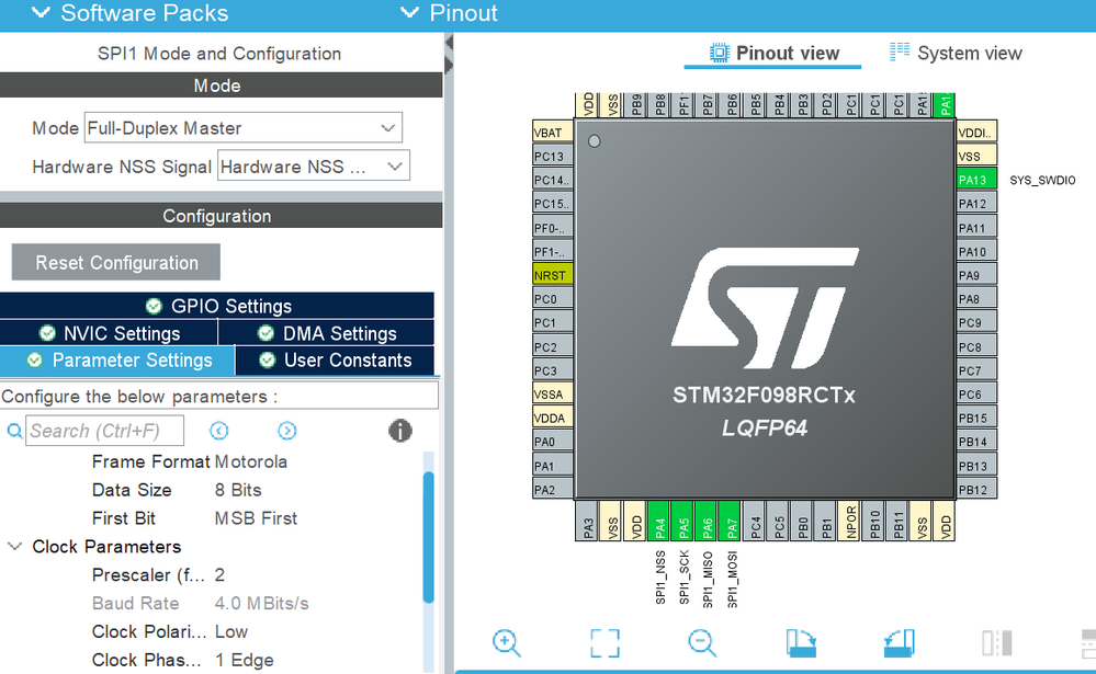

PA4 is configured as Hardware NSS output signal.
So that means it is controlled automatically by the SPI hardware - but your code is doing it in software.
Also, you do the transfer in two steps:
	HAL_SPI_Transmit(&hspi1, &address,1,50);
	HAL_SPI_Receive(&hspi1, &Received_data, 1, 50);
With hardware NSS control, that means NSS will be released between the two transactions - so that won't work.
Again, looking on the wires with an oscilloscope or logic analyser would show you what's going on ...

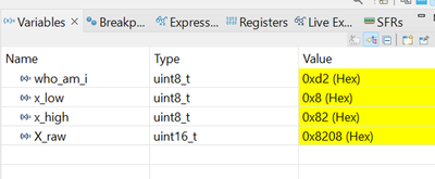

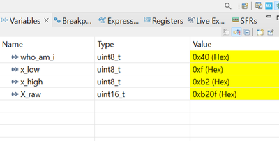

Hi Andrew,
I tried again and now I am getting different values for who_am_i register which include 0x44 also. But each time when debugging, different values are getting.
These are the values I got for who_am_i and x register.
Please go through it and comment on it. It will be so helpful.

@DivyaJayan wrote:
Already checked the wires with oscilloscope and got correct clock burst.
You could have mentioned that earlier!
So you get a clock - but what about the other lines?
