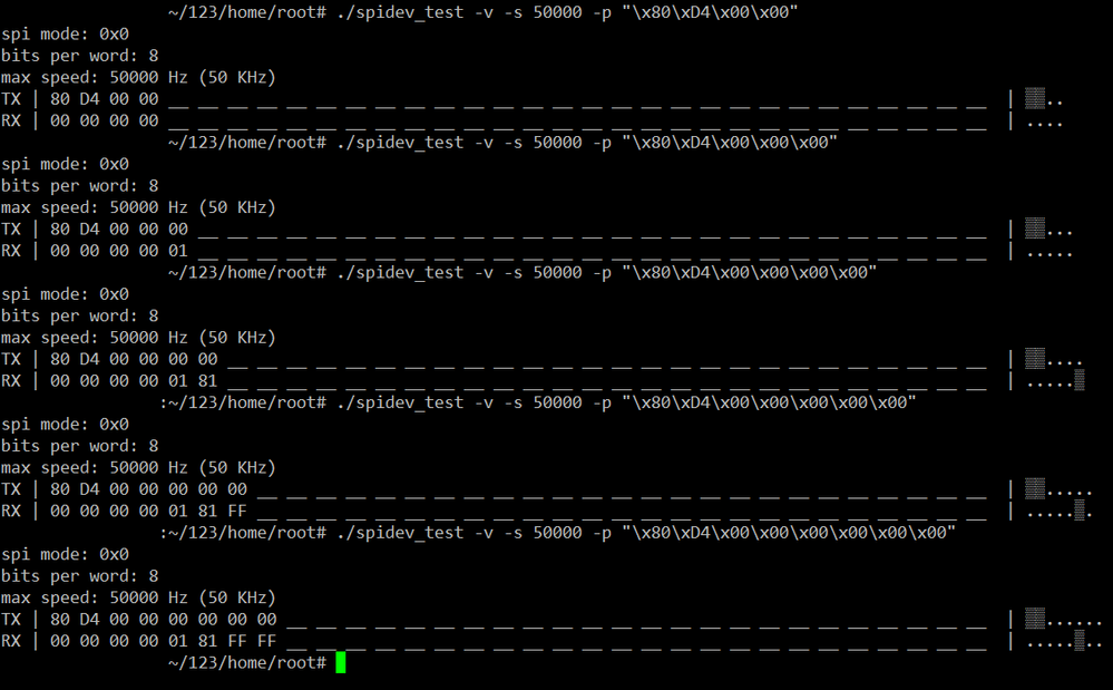

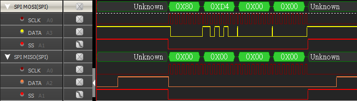

Check the logic analyzer, the driver code cannot handle wait state of tpm on my platform (tpm_tis_spi.c).
I also replace tpm driver to spidev driver and run the spidev_test (https://github.com/rm-hull/spidev-test/blob/master/spidev_test.c) tool under linux.
The result shows I need send out more byte to get correct respond on my platform, is that the correct behavior?
If this is correct behavior, any suggestion about tpm driver cannot access spi well?
