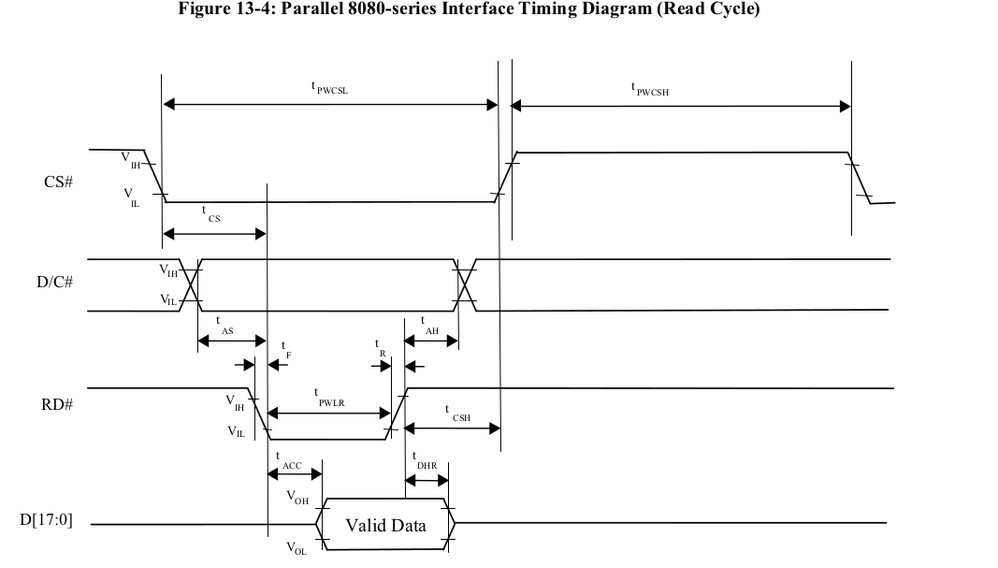

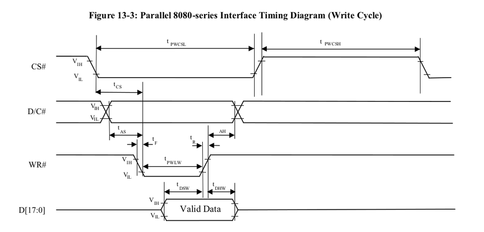

I my first reply I asked you to provide *captured* waveforms; you pointed me to that parallel post where a screenshot from an old version of the DS was posted, with waveforms completely out of normal i8080 sequence.

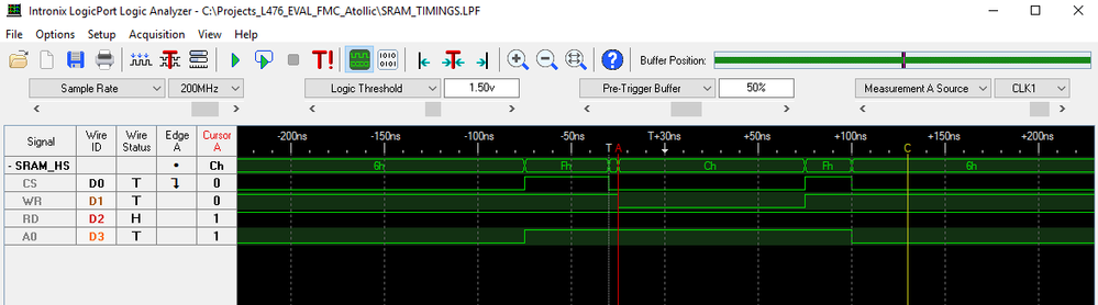

And Here is what the Read Cycle on the Eval Board's FMC looks like on my Logic Analyzer: Please note that I am running the FSMC/FMC in SRAM Mode-B operation

You've posted the same picture twice.
You did not post the content of relevant FSMC registers.
In the 'L476 there's no FMC according to my copy of RM0351.
According to UM1855, some of the data lines are brough out to RM6/RM7. Btw, how did you connect the display physically?
There's also something terribly wrong: the write pulse should end (rising edge) one HCLK before CS (rising edge). What's the HCLK frequency?
Also the fact that CS goes low soon after that write is suspicious, I see no reason for that.
Set the analyzer to 500MHz otherwise the granularity of 5ns at 200MHz might cause some edges to appear to overlap.
