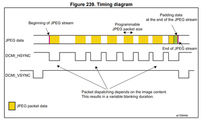

In your application note AN5020 and related to JPEG reception. i have some questions and hopefully you can answer them so every thing work.
Each JPEG stream is divided into packets, which have programmable size
What does JPEG Stream means? is it JPEG frame or what exactly?
What packets mean? Minimum Code Unit (MCU) or what?
also how many packet can be received between every HSYNC, one packet or more?
how this packets can have programmable size and which register responsible for this?
This figure in the reference manual illustrates the dispatching of data. DCMI_HSYNC signal act like blanking signals.

2023-09-04 5:48 AM
That the image is compressed into a JPEG file format (w/headers) as a compact way of transmitting the frames. MJPEG (Motion JPEG) is a series of frames, each basically a key-frame in JPEG format.
I'd assume you unpack the stream, finding the JPEG header, recovering file size details, and then saving to a file, or reprocessing. You'd need to unpack the frame to get an image you could display a frame buffer.
