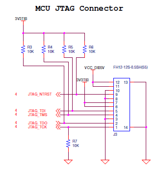

I am using the Segger J-Link+ to connect to my target board with the STM32F103RD chip installed. I connected all the necessary pins of the target board (TMS, TDO, TDI, NTRST, TCK, and RESET) to the corresponding pins of the J-Link. Before, I was able to connect to the target board and upload my firmware using J-Flash with no problem. All of a sudden, when I was trying to upload new firmware to the board, I got the ''ERROR: STM32: Connecting to CPU via connect under reset failed.'' I've been looking for possible solutions, but still no luck and I've resorted on posting in this forum. All the connections are connected properly and the board is powered up as before. The chip doesn't seem to be bricked since the last firmware that I loaded is still running whenever I push the buttons. I really hope someone could help me with this. Any help will be appreciated.2016-08-03 10:07 AM

Flawed design/implementation?That SWD works and JTAG doesn't suggest pin connection issues?I have very little to work with here, I'm not familiar with your design/implementation/connectivity. I know the boards I've worked on don't have these issues, so assume the issue is mostly at your end, and not ST's or Segger's2016-08-03 4:12 PM

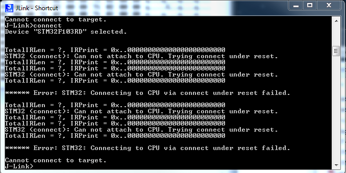

You'd want to try another board, or replace the chip. What exactly does the entire connection log from J-Link commander look like? Does it expect you to connect VCC along with GND. The circuits would always need a common ground, the IO buffers may also require a target supply. You'd want to use standard JTAG/SWD headers in designs, it makes connectivity easier and consistent.2016-08-04 8:28 AM
Here's the log from the JLink after trying to connect with the board with boot0 High:
