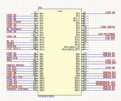

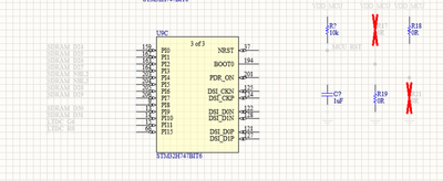

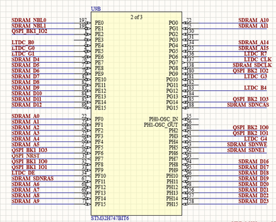

Apologies for the earlier incomplete information. Please find the updated connections to the MCU attached for your reference.
Regarding R17, R18, R19, and R21, only R18 and R19 are currently mounted.
