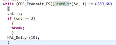

2023-08-21 6:47 PM - edited 2023-08-21 7:55 PM
I did as follow.
2023-08-21 8:42 PM - edited 2023-08-21 8:48 PM
I found a reason.
When software restart, USB device is not working properly. I don't know exactly.
In first CDC_Transmit_FS(), watchdog timer is expired.
Because, I call while (CDC_Transmit_FS((uint8_t*)&c, 1) != USBD_OK); to ensure tx opeation thru USB is completly before next tx.
At this line, watchdog is working. It looks not working my board.
Temporary, I modify this line and test like this.
And go next step.
