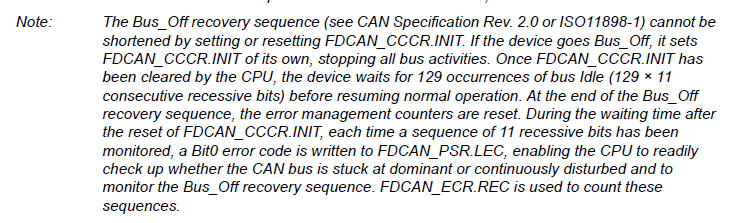

Normally You don't need the reset a FDCAN controller when he is in Bus_off state, it should be sufficent to reset the INIT Flag in the CCCR register. This will make the Controller recover from Bus_off once the cause is removed.
From the reference manual capter 56.5.13:
2025-08-22 6:24 PM
Thank you for the good guidance.
