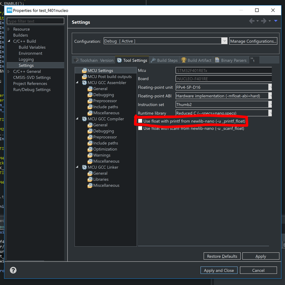

In STM32CubeIDE, there is a checkbox to enable support for floats within printf. If "\0" is a null character, looks like your current implementation simply ignores the "%f" specifier.
2020-07-30 4:02 PM
Heh, yeah, I actually stumbled across that and enabled it and was poking around at it. Tried moving from sprintf to printf (since the prompt mentioned printf) but that didn't work. Went back to sprintf and it started working for y. Which is when things get odd (and kind of explain why I was getting some odd results) . . .

I assume the checkbox includes sprintf as well as printf. Obviously printf won't work unless you've explicitly rerouted printf output somewhere.
