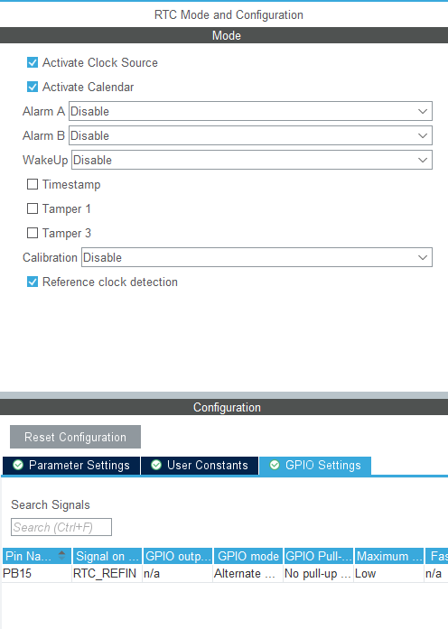

i set refclk in Cube->
_legacyfs_online_stmicro_images_0693W00000bilqFQAQ.pngthen cube gen ->
 /** Enable the reference Clock input
  if (HAL_RTCEx_SetRefClock(&hrtc) != HAL_OK)
    Error_Handler();
  /* USER CODE BEGIN RTC_Init 2 */
-> and no GPIO_PIN_15 init in main ... !
I don't use Cube, so I'm not sure how the code generation works, but the GPIO init is probably somewhere. Still, as waclawek.jan said, the GPIO mode I had was INPUT while your screenshot shows it in Alternate, so I'm redoing the test with it in GPIO_MODE_AF_PP. (I think we'd tried this config before, but better to be sure)
