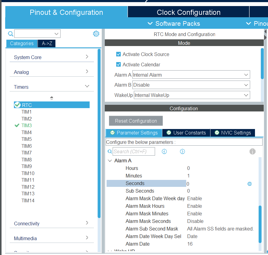

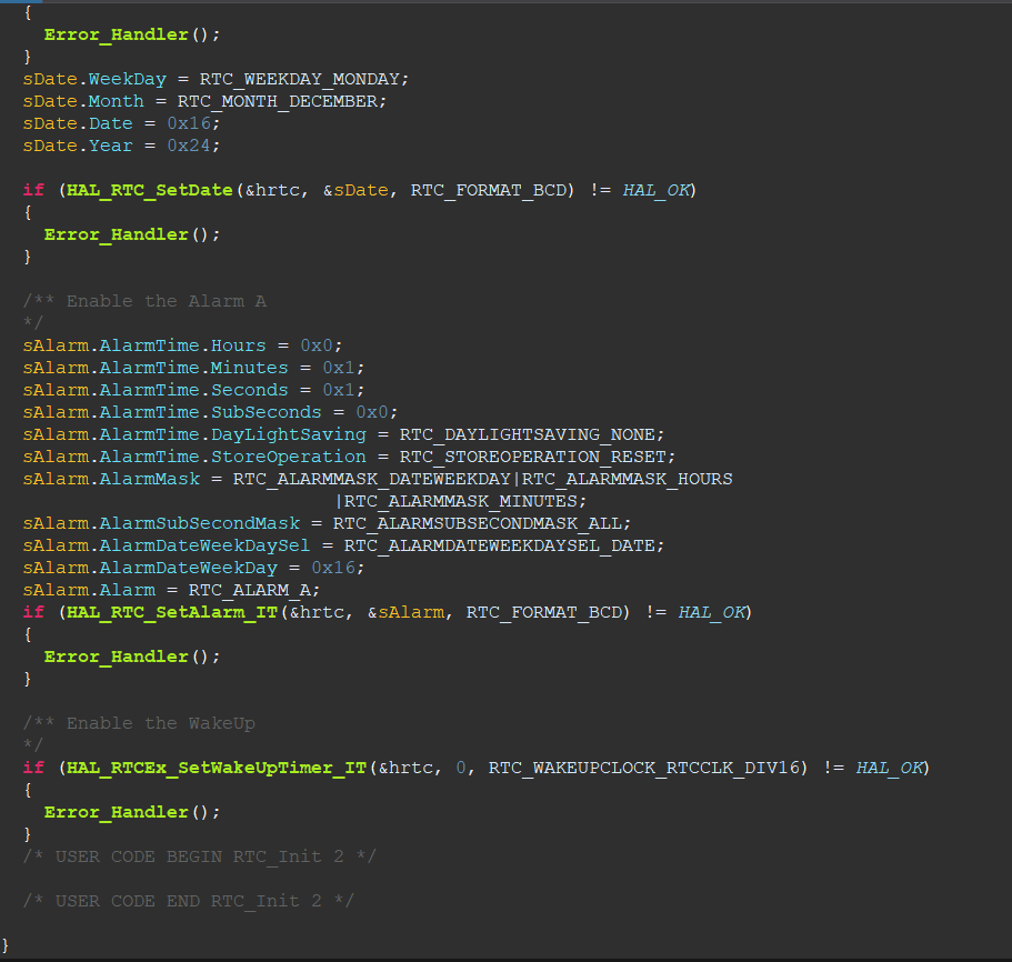

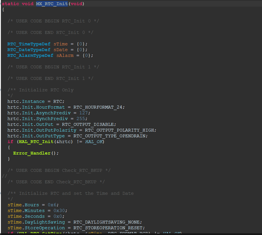

I am using the STM32F407G-DISC1 development board and have successfully implemented an RTC alarm that triggers every minute. The RTC is configured to use the LSI (Low-Speed Internal) clock signal.

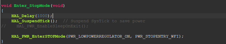

My goal is to have the microcontroller enter sleep mode and wake up after 3 minutes using the RTC wake-up feature. However, when the MCU enters sleep mode, it wakes up prematurely, within only 2 seconds, instead of the expected 3-minute wake-up period.

RTC init_1
RTC init_2
Stop function
wake up function

Procedure for waking up in the future:
Your current code wakes up when seconds = 1 and ignores minutes.
