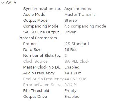

easy test , to see whats possible (with your clock settings! ) :
look in Cube, what it calculates for your different output frequencies ->
good clock chosen for 44.1 k ; now when choose 96k as desired output ->
15% too high - but better not possible with this clock setting
so you can optimize for one output frequency always, but for many frequencies will be some compromise.
