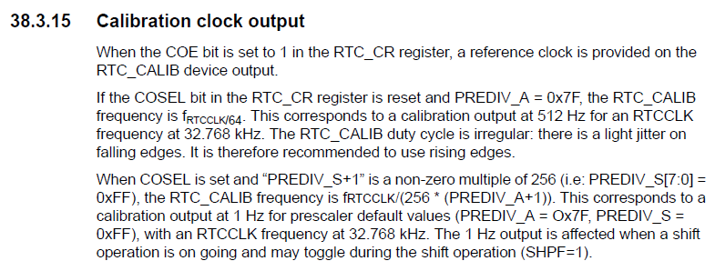

For the second issue, RTC_OUT is not 1 HZ because the 1HZ freq taken from fRTCCLK/(256 * (PREDIV_A+1)) =128
The PREDIV_A=0.

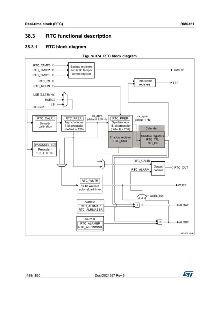

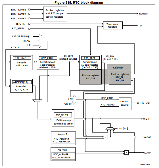

Results observed from RTC_OUT is then consistent, reference manual is confusing because RTC block diagram:
shows ck_spre is connected to RTC_CALIB and so I expect 1Hz for PREDIV_A: 0 and PREDIV_S: 32767.

It correctly depicts the RTC_CALIB to be outputs from the dividers - the ''512Hz'' is obviously a tap from the 6th bit of async divider and the ''1Hz'' is a tap from the 7th bit of the sync divider (ST: the narrative might say so, not just having described behaviour when mägic values are present in the prescaler regiters).
