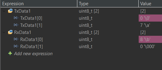

I have debugged the whole code to send data from stm32h750b-dk between the two fdcan terminals fdcan1 and fdcan2 the data is appearing on live expressions of txdata1 but in rxdata only 1 bit is being transferred can somebody mention what the problem could be
all my parameters are adjusted accurately
Txdata[2]={7,8};
this is the output which is shown can somebody help me out on wtt could be done

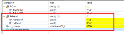

This is a screen shot of the debug session, the bytes 7 and 8 are well received with FDCAN2 and a counter counting the number of the reception I've added in the example:

Here Txdata (do you mean Txdata1?) contains two bytes 7 and 8 but in the live expression it's showing 0 and 7. That's not clear.

yes Txdata1 is from fdcan1 and rxdata1 being recieved from fdcan2
like an array of TxData1={7,8} is being transmitted in my live expressions it only sends '8' to RxData1 and the rest buffer becomes 0 in TxData1 and other becomes 7 so basically Rxdata1 is receiving only 1 byte of 8

2025-01-29 6:28 AM
Thank your for the sharing.
You didn't activate the FDCAN2 IRQ:
I'm attaching your project (modified) where FDCAN2 is receiving these two bytes.
