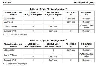

As you can see on the Table63 and Table 64 of the RM0360 rev5
if you enable the LSE, the PC14 and PC15 will be automatically set for LSE use. If you want to use them as standard GPIO you have to set LSEON bit in
RCC_BDCR register PC14MODE bit and PC15MODE bit to 0 and configure the GPIO as standard one using the usual registers. I think throw CubeMX, you just have to disable LSE and enable the GPIO on the mode you want.
