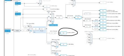

2023-11-11 11:43 PM
yes the ADC clock input is 72MHZ and also i am using fast adc channel .
