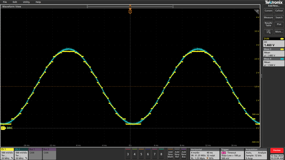

2020-09-15 1:29 AM
This is the waveform from DAC. you can clearly see the steps (about 64, however they aren't evenly distributed).
We checked another Nucleo board and one of our designs at another test bench and all show the same behavior.
This is really strange and too obvious to not to be detected before.
Yellow: DAC output at PA4 pin; Blue: signal from signal generator at PA0 pin
2020-09-15 1:50 AM
I dont see code, what you use but some mistake must exist. As first how amplitude have your generator ? Realy use full range of AD and how DC offset.
Second how type parameter use DEBUG_SECTION_DAC1_CH1 ( ?) . 3.how big is ADC clock/speed/sample time vs out impedance of generator eq dB down...
I check your scoped graph and here isnt 1kHz but 50Hz
2020-09-15 2:03 AM
